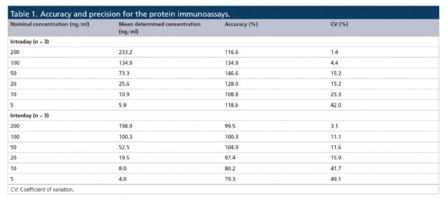

精密度

• The method validation results demonstrated satisfactory characteristics in specificity, linearity, accuracy and precision.
• This protocol avoids the need of laborious and costly customized monoclonal antibody as is typically essential for an ELISA or multistep enrichment process which are often indispensable when employing a liquid chromatography–mass spectrometry-based method.
• The protocol is capable of quantifying up to 25 samples at the dynamic concentration range from 5 to 200 ng/ml with an LLOQ of the target protein at 0.4 nM (20 ng/ml).
