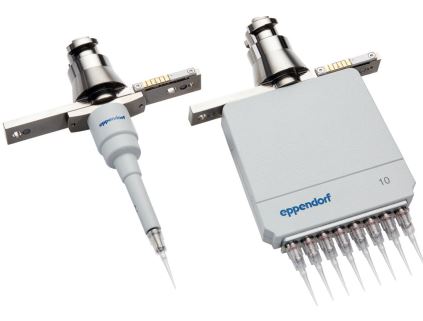

The new 10 µL dispensing tool developed for the epMotion automated liquid handling systems allows the dispensing of volume as low as 200 nanoliter. The complete volume range covered by all epMotion dispensing tools is now extended from 0.2 µL to 1000 µL. The use of this new accessory en sures accurate and precise automated dispensing of sub microliter volumes. The purpose of this Application Note is to demonstrate the efciency of the 10 µL tool in a qPCR setup by using sample volumes as low as 200 nanoliter.
