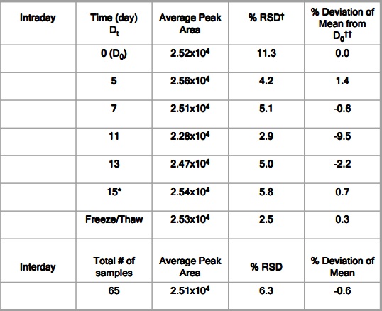

Table 1. Statistical Analysis of THRX-776005 Stability Study in microtainers based on average concentrations.

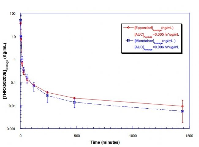

Figure 4. PK profile of THRX-502038 comparing plasma samples collected in microtainers versus samples collected in Eppendorfs.

Compound instability in the microtainer is minimal as shown in Figure 3 and defined in Table 1.
Non-specific binding of compounds during routine use and storage has not been seen as shown in Figure 3.
There were no great differences between using Eppendorfs (original method) and using microtainers (current method) to store plasma samples as shown in Figure 4.
