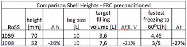

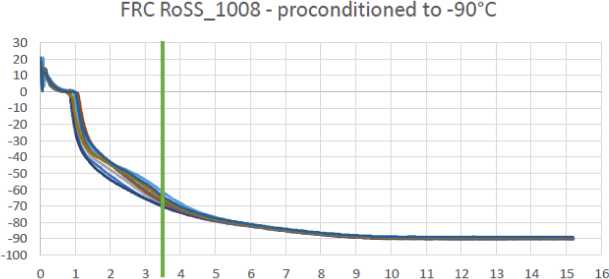

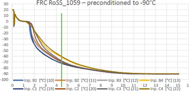

2. mRNA Freezing experience
mRNA冷冻实验 得到的工艺数据。
mRNA experienced companies are freezing as fast as possible, so with rates from + to -60° C in < 5hours
经验丰富的mRNA公司会尽可能快地冻结mRNA(在< 5小时内从+到-60°C冻结)
