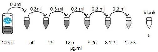

2, Standard:
1). 100ug/ml of standard solution: Add 1 ml Sample / Standard dilution buffer into one Standard tube, keep the tube at room temperature for 10 minutes and mix them thoroughly.
2).50ug/ml→1.563ug/ml of standard solutions: Label 6 Eppendorf tubes with 50ug/ml, 25ug/ml, 12.5ug/ml, 6.25ug/ml, 3.125ug/ml, 1.563ug/ml, respectively. Add 0.3 ml  of  the Sample/Standard dilution buffer into each tube. Add 0.3 ml of the above 100ug/ml standard solution into 1st tube and mix them thoroughly. Transfer 0.3 ml from 1st tube to 2nd tube and mix them thoroughly. Transfer 0.3 ml from 2nd tube to 3rd tube and mix them thoroughly, and  so on.
Note: It is best to use Standard Solutions within 2 hours. The Standard Solution shall be at 4°C up to 12 hours. Or store it at -20 °C up to 48 hours. Avoid repeated freeze-thaw cycles.

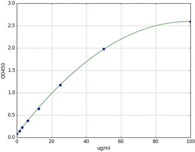

Typical Data & Standard Curve
Results of a typical standard operation of a Ig ELISA Kit are listed below. This standard curve  was generated at our lab for demonstration purpose only. Users shall obtain standard curve as per experiment by themselves. (N/A=not applicable)
X ug/ml 0 1.562 3.125 6.25 12.5 25 50 100
Y OD450 0.079 0.145 0.227 0.378 0.643 1.177 1.984 2.592
