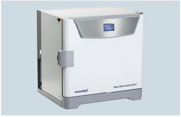

Although MSCs have enormous advantages for regenerative medicine, drug screening and drug discovery, their applications are limited by the quantities required for industrial or clinical applications3. In this study, we developed a simple shake flask culture technique to expand MSCs on microcarrier beads which can be used to scale-up into large-scale bioreactors. The microcarrier shake flask culture, which requires both agitation and CO2 gas control, was conducted in the Eppendorf New Brunswick S41i CO2 incubator shaker.
The New Brunswick S41i CO 2 Incubator Shaker, designed for both non-adherent and adherent cell culture applications, combines the precise temperature and CO2 control of an incubator with the reliable New Brunswick laboratory shaker drive mechanism. Key features include sealed inner/outer doors, high-temperature disinfection, and reduced CO 2 consumption compared to competitor models4.

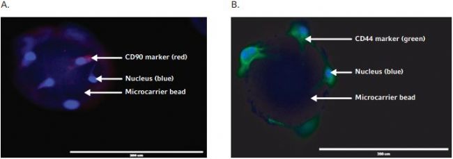

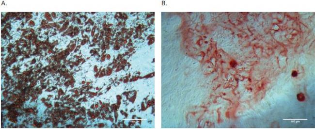

To determine whether or not AdMSCs retained their stem cell properties during their growth under shake flask conditions, immunostaining of stem cell surface markers and differentiation assays were performed. Microcarrier beads that contained AdMSCs were immunostained with stem cell surface marker antibodies such as: FITC conjugated antihuman CD44 and APC-conjugated antihuman CD90 and revealed that AdMSCs retained stem cell surface markers during growth under shake flask culture condition (Figure 2A&B). For the adipocyte and osteocyte differentiation assays, AdMSCs were collected from the microcarrier beads and seeded into 24 well plates that contained either adipocyte or osteocyte differentiation medium. After 17 days of culture, the plates were stained with Oil Red O or Alizarin Red S staining solutions, respectively. Microscopic observation indicated that most of the AdMSCs from shake flask culture differentiated into either adipocytes or osteocytes successfully (Figure 3A&B).

Figure 2. Stem cell marker identif cation assay for AdMSCs expanded on microcarriers in shake fl ask. A) AdMSCs on microcarrier beads are positive for CD90 stem cell marker, as indicated in red by fl uorescence imaging. B) AdMSCs on microcarrier beads are positive for CD 44 stem cell marker, as indicated in green by Fluorescence Imaging. Blue color indicates stem cell nuclear staining by DAPI.
Figure 3. Diff erentiation assays for AdMSCs expanded on microcarriers in shake fl ask. A) Adipogenic diff erentiation formed lipid droplets as indicated by Oil red O positive staining. B) Osteogenic diff erentiation caused calcium mineralization of extracellular matrix as indicated by Alizarin Red S positive staining.
