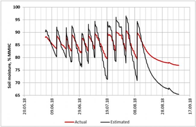

摘要:用于确定蒸散量 (ETc) 的 Penman-Monteith 方法的计算方程源自土壤表层能量平衡,ETc对ETo的依赖性反映了培养系数Kc。由于 Kc (FAO) 的值是标准气候条件的典型值,被定义为亚湿润气候,因此有必要针对气候较干燥的乌克兰草原的条件评估该模型。因此,科学研究的目的是使确定 ETc“Penman-Monteith”蒸发量的计算方法适应乌克兰草原对大豆作物的灌溉条件。工作涉及进行短期现场实验、普遍接受的分析研究方法;使用方差、相关、回归和变分分析方法。使用数字互联网气象站 iMetos® 和多传感器探头 AquaSpy CTG-02 建立实际的大豆灌溉制度、ETo 的参考蒸散量、ETс 的蒸散量计算值和实际值。根据大田试验结果,根据不同成熟度组大豆品种的主要发育阶段,利用与标准条件的偏差,调整作物系数Kc。研究证实,乌克兰草原灌溉条件下大豆的实际作物系数 Kc 值不同于典型的 Kc (FAO)。研究发现,在植物发育的初期和末期,Kc(FAO)高估了ETc蒸散量的实际值42.8%,而在中期,反而低估了4.2-11.5%。在标准条件下计算蒸散量时使用 Kc (FAO) 会导致大豆生长季节开始和结束时过度浇水,以及在植物发育的关键时期(“开始阶段”)水分储备不足。开花倒豆”)。建议今后使用“Penman-Monteith”方法确定ETс的实际蒸散量,并在此基础上对大豆灌溉制度进行操作控制,同时考虑培养系数Kc的调整值。
The calculated equation of the Penman-Monteith method for determining evapotranspiration (ETc) is derived from the equation of energy balance of the soil surface, and the dependence of ETc on ETo reflects the culture coefficient Kc. Since the values of Kc (FAO) are typical values for standard climatic conditions, which are defined as sub-humid climate, it is necessary to evaluate this model for the conditions of the Steppe of Ukraine, whose climate is drier. Thus, the aim of scientific research was the adaptation of the calculation method for determining the evapotranspiration of the ETc “Penman-Monteith” to the irrigated conditions of the Steppe of Ukraine on the soybean crop. The work involved conduction of shortterm field experiments, generally accepted analytical research methods; the use of methods of variance, correlation, regression and  variational analysis. The actual soybean irrigation regime, the reference evapotranspiration of ETo, the calculated and actual values  of evapotranspiration of ETс were established using the digital Internet meteorological station iMetos® and the multisensor probe  AquaSpy CTG-02. Based on the results of the field experiment, the crop coefficient Kc was adjusted according to the main phases  of development of soybean varieties of different ripeness groups using deviations from standard conditions. The research confirms  that the value of the actual crop coefficient Kc for soybeans under irrigation conditions of the Steppe of Ukraine differs from the  typical Kc (FAO). It was found that at the initial and final stages of plant development, Kc (FAO) overestimates the actual values of  ETc evapotranspiration to 42.8%, and in the middle phase, on the contrary, underestimates by 4.2-11.5%. The use of Kc (FAO) in  the calculations of evapotranspiration for standard conditions leads to over-watering at the beginning and at the end of the growing  season of soybeans and a deficiency of moisture reserves in the critical period of plant development (phase “beginning of floweringpoured beans”). It is recommended to use the “Penman-Monteith” method in the future to determine the actual evapotranspiration  of ETс and operative control of the soybean’s irrigation regime on this basis, taking into account the adjusted values of the culture  coefficients Kc.

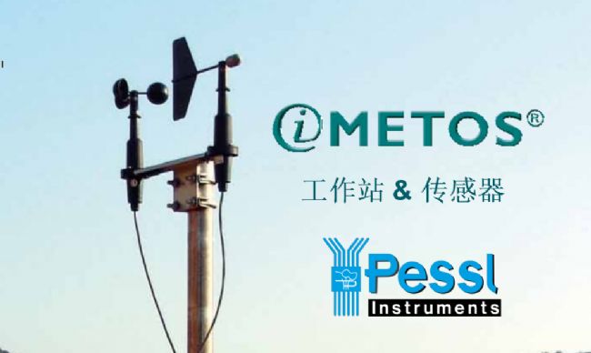

Pessl植物生理生态监测系统的数据采集工作站可以将这些数据无线传输到安全的互联网数据库上。该数据库是优秀的数据存储和处理平台。用户获得登录密码后,可以从世界任何地方的互联网终端登录并获得这些数据、报告和图表。测量的信息来源于传感器所在的位置。使用者可以从网站上一个区域可输入或修改阈值和电话号码。操作无需专门软件。
Pessl植物生理生态监测系统仅需要有效的GPRS协议用于数据传输,在站点所在处也需要网络的充分覆盖。该系统是一组多功能、模块化配置的系统,运行完全免维护。该工作站采用太阳能充电电池。工作站可以连接多种传感器。即插即用模式便于工作站扩展传感器数目。
